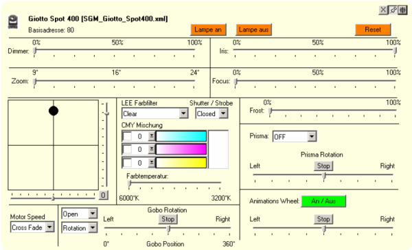

Figure 1: Graphical view with DDF icon |
Figure 2: Opened DDF window with control elements |
DDF is the abbreviation of Device Definition File. The DDF are the device description (Fixtures) in DMXControl, they serve to inform DMXControl about the functions of the attached DMX device to this. In the DDF the number becomes this one how channels of the DMX device defined and as well these use possible control elements:
- Position input control element e.g. at Movingheads and Scanners.
- RGB or CMY color choice control element to the color mixture at e.g. LED headlight or color mixed units at Movingheads.
- Dropdown control elements
- Button control elements.
Become the DDF in the « graphical view » with an icon of the device shown (see figure 1), then also can here be accessed the icon, the DDF window by a click with the control elements (see figure 2). XML format which is translated by DMXControl into the internal device description is carried out the description the DMX equipment in one. The DDF are found the DMXControl main directory in the sub-folder DEVICEs. The accompanying icon pictures, which one in the & laquo; Graphic stage view & raquo; be, lie in another sub-folder named shown images.

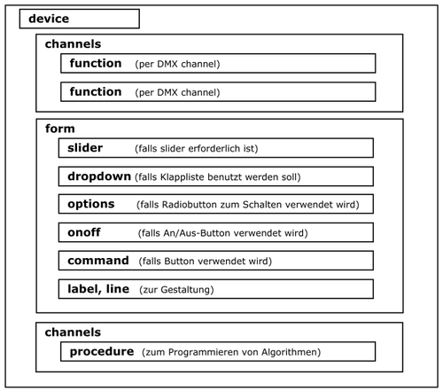

Every description contains four main parts (see figure 4):
- Description of global qualities device (in the example dimmed spotlight line 1-2)
- Description of the individual DMX channels channels (in the example dimmed spotlight line 3-5)
- Description of the graphic context menu form (in the example dimmed spotlight line 6-11)
- Prozedure code (not contained, optionally in the example)
Figure 4: Basic structure of a DDF |

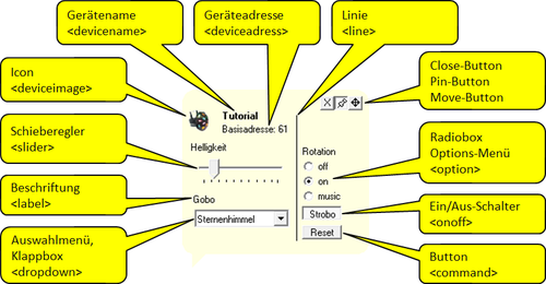

All form elements must on the will provide DDF form with graphic coordinates to the positioning. The elements „Label“ and „Line“ are passive and serve only the design of the surface. The remaining active elements of the form (also control element mentioned, e.g. on/off) can be used for the active control of the DMX device.
Graphical elements
The figure 5 shows a survey of all supported graphic elements. An assignment to the required syntax elements is carried out in the explanation texts.
Figure 5: Graphic elements |

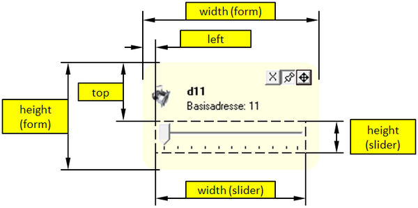

The following figure 6 illustrates the meaning of the graphic coordinates of the control elements:
Figure 6: Graphic coordinates of the control elements |

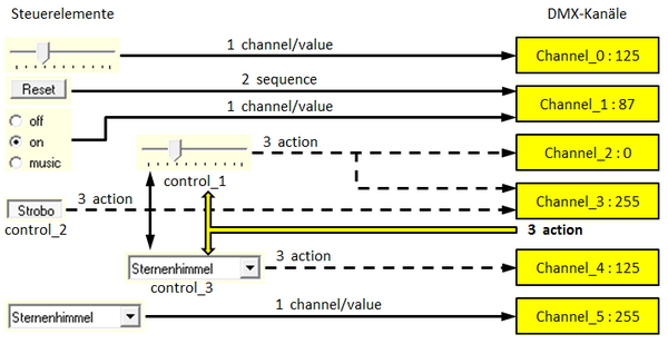

The active control elements interact in 3 possible concepts with DMXControl or the device in which exactly one concept is selected at the definition of a concrete control element:
Konzept | Beschreibung | Beispiel | |
1 | Channel/Value concept | The control element is assigned via the channel attribute to a concrete channel. Concrete values or ranges of values which are put at the activity of the control element are defined in the control element. | - option list caption="Star sky" value="165" - Value range of the slider startvalue="0" endvalue="255" |
2 | Sequences | An instruction consequence which is executed when operating is defined in the control element as a string. | clicksequence= “set 1 75; set 2 100“ |
3 | Action/Procedures | A separately defined procedure contains more complex program instructions. The procedure is operate assigned via the action attribute and at everybody the control element executed. | action="SetGobo" |
This which Channel attribute and the action attribute can want to use alternatively in the control elements particularly means.
For many applications the first two concepts are sufficient. |
Like the complexity and cardinality of the 3 concepts grows, the running time requirements also increase. The simplest variant on the solution of a task should therefore always be chosen. Also at the channel description an action attribute can be used. This means that the procedure is called at every change of the channel value. In figure 7 an example is shown how different control elements can interact with the channels. „So like the complexity and channel_n“address and can over the 3 mentioned above concepts be put. The current value, obliged to it for a control element are, are addressed more than one name freely eligible for office (reference) assigned to the control element here „control_n“bezeichnet. Im following example is for three control elements „Actionses“and additional „Reference names“assigned. And therefore should, as a rule these Actionses be able to do one or put several Channel values „set name“being described. Furthermore there is one „action“ assigned to the channel_3. This is intended to read and to inform about to the control elements the current channel values „assigned to the channel_3. Scheduled, this one are Get name this for this“get since she must read current channel values.
Figure 7: Interaction of control elements |
The markings of the buttons don't have a meaning here. |

<options> | Level 3 Subtag from “<form>“; Creates a radio button field |
top left |
See generic attribute GP3 & GP4 |
integer | ||
channel | Assigned channel alternative foraction | integer optional |
action | Call of a procedure at change of a radio buttons, alternative for channel |
optional | SetGoboSpeed | |
name | Referenz name for procedure code (variable name) |
string optional |
GoboSpeed | |
<option> | Level 4 Subtag from “<options>“ |
caption | See generic attribute GP2 |
string | off | |
value | DMX value for caption | integer | 0 | |
top left |
See generic attribute GP3 & GP4, relativ position for positioning from “<options>“ |
integer | left="0" top="0" |
On/Off-Button
Tag | Attribute | Hierachie and properties | Notice | Example |
<onoff> | Level 3 Subtag from “<form>“; Creates a button as switch |
top left width height |
See generic attribute GP3 bis GP6 |
integer | ||
channel | Assigned channel alternative for action | integer optional |
action | Call of a procedure at pushing the buttons alternative for channel |
string optional |
SetLampOnOff | |
name | Referenz name for procedure code (variable name) | string optional |
LampOnOff | |
caption | Explanatory name | string | On/Off | |
color | Hex RGB color value of the button | hex | color="#00ff00" color green | |
onvalue | DMX value for button ON | integer | onvalue="150" | |
offvalue | DMX value for button OFF | integer | offvalue="0" | |
onsequence | Execute a Sequence, by switching to ON | string | "set 0 230; set 1 25" | |
offsequence | Execute a Sequence, by switching to OFF | string | "set 0 0; set 1 0" |
Command-Button
<command> | Level 3 Subtag for “<form>“; Creates a button as push button. |
integer | ||
action | Call of a procedure at pushing the button. | string optional |
SetReset | |
Reset | |
caption | Explanatory name | string | Reset | |
color | Hex RGB color value of the button | string | color="#0000ff" color blue | |
clicksequence | Activity to be started at the button click is specified in the attribute | string | "save 0; set 0 230; hold 5500; restore 0" | |
downsequence | Activity to be started at push down the button is specified in the attribute | string | "save 0; set 0 230; hold 5500; restore 0" | |
upsequence | Activity to be started at relase the button is specified in the attribute | string | "save 0; set 0 230; hold 5500; restore 0" |
Colorpicker
<colorpicker> | Level 3 Subtag from “<form>“; Creates a colorpicker. |
integer | ||
channel1 | Assignment to 1. channel red oder cyan, alternative for action |
integer optional |
channel2 | Assignment to 2. channel green or magenta, alternative for action |
integer optional |
channel3 | Assignment to 3. channel blue oder yellow, alternative for action |
integer optional |
ColRGB | |
action | Call of a procedure at changing a color, alternative for channel1-3 |
string optional |
SetColRGB | |
mode | Choice of the two modes RGB or CMY |
string | mode=“cmy“ | |
layout | Choice of two different layouts from the Colorpickers |
integer | layout="1" |
Beispiel:
<colorpicker mode="rgb" channel1="0" channel2="1" channel3="2" layout="2" top="40"
left="0" height="75" width="177"/>
Please keep the mouse button pushed down if you want to change the setting in the color bar over the drop down menu. A direct input of the numeric value is also possible.
Become the color values in procedures about name:colorchannel provided with references ({ColRGB:1}; {ColRGB:2}; {ColRGB:3}) |
Passive design elements
<line> | Level 3 Subtag from “<form>“; Design element; Creates a line. |
x1; y1 | Start coordinate of the line | integer | ||
x2; y2 | End coordinate of the line | integer | ||
<label> | Level 3 Subtag from “<form>“; Design element; additional description of an operating device. |
integer | ||
caption | Text to be shown | string | CMY Mischung |
