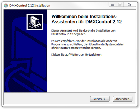

Welcome
Figure 2:The welcome dialog
Figure 2: The welcome dialog
|| You are informed on this screen which software you are installing. With a click on the button « Next », you will then see the license dialog.

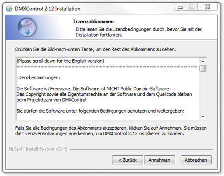

License
Figure 3:The license authentication window
Figure 3: The license authentication window
|| The end-user license is shown on the license dialog by DMXControl in two languages. Into this you are requested to accept the terms of the license. Among other things the licence describes what you can and cannot do as a user of the software. You must accept the license agreement by a clicking on the button « Accept ». By agreeing to these terms you accept the legal rules even though this is free software.

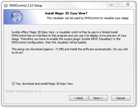

Install EasyView?
Figure 4:3D-Easy View Installation request
Figure 4: 3D-Easy View Installation request
|| Once the license agreement the question is accepted, you are asked if the 3D-Visualizer Magic EasyView shall be installed? The Visualizer is a very useful tool where one prepares the shows and layouts of the stage. xxxxxx ??? About as much 3D energy as this one the Dektop at home has, can't be renounced the 3D representation also safely on the live laptop computer.xxxxx???

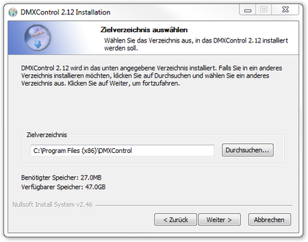

Destination directory
Figure 5:Choice storage location
Figure 5: Choice storage location
|| At the next step you select the target installation directory that DMXControl 2 will use. The default path is already suggested and, if you don't have any special requirements, use this one safely. The suggested directory will vary depending on the operating system, version and language. Under a German 32 bit Windows (XP, Vista, 7) it is the suggestion "C:\Programme\DMXControl" and at the English 32 bit version is "C:\Program Files". At a 64 bit Windows the suggestions are, however "C:\Programme (x86)" or "C:\Program Files (X86)".

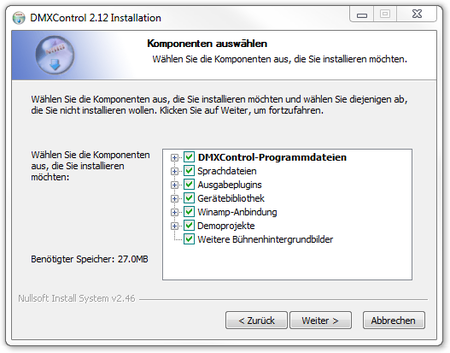

Program features
Figure 6:Choice of the components to be installed
Figure 6: Choice of the components to be installed
|| You are now presented with a detailed choice of the installation items. With the standard installation, all features of the software are selected and you can move directly to the next step. If you wish to carry out an installation with a slimmed down version, on another system for instance, you can omit certain features as you wish. Since DMXControl 2 does not occupy much hard disk space, the simplest variant is the complete installation.

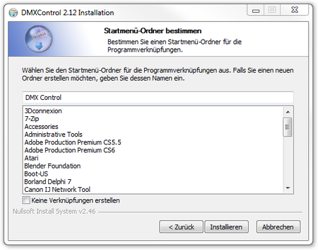

Start menu directory
Figure 7:Entry in the start menu.
Figure 7: Entry in the start menu.
|| Lastly, you will asked for the name for the entry in the start menu. The standard suggestion is DMXControl.

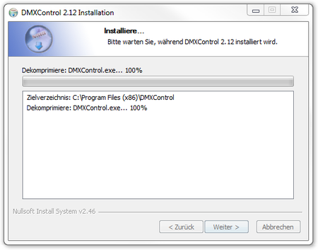

Installation
Figure 8:Install progress
Figure 8: Install progress
|| The selected parts of the software are decompressed and installed on your computer.

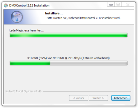

Download EasyView (optional)
Figure 9:Download of Easy View
Figure 9: Download of Easy View
|| If the option for the EasyView installation was selected, the download of the EasyView installation program starts now.

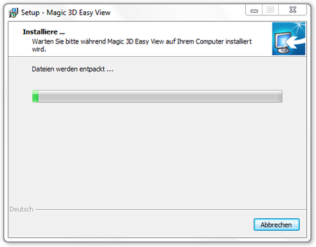

Installation EasyView (optional)
Figure 10:Installation of Easy View
Figure 10: Installation of Easy View
|| The installation of EasyView starts completely automatically and does not need any user input.

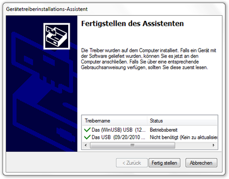

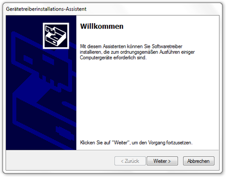

Installation EasyView driver (optional)
Figure 11:Driver installation for Easy View
Figure 11: Driver installation for Easy View
|| During the installation of EasyView, drivers are installed into the system. The installation dialog provided by Windows will show for device drivers. This can started simply by pressing the « Next » button.
Install all EasyView drivers (optional)
Figure 12:Conclusion of the Easy View installation
Figure 12: Conclusion of the Easy View installation
|| If the drivers are installed successfully, this part can be completed and you will return to the installation assistant of EasyView and then to the DMXControl 2 installation.

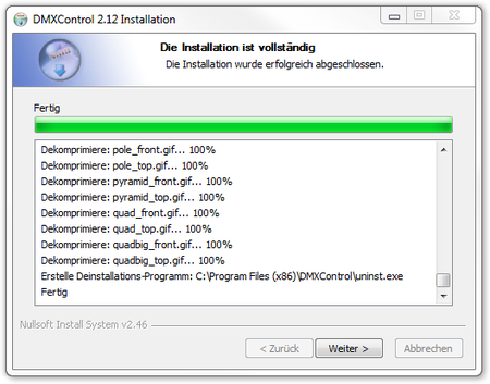

Installation progress
Figure 13:Complete installation
Figure 13: Complete installation
|| You have the option of looking at the summary of the installation at the end of the process including where EasyView was installed. This path is important if you need to integrate additional Fixtures in EasyView, so you should make a note of the path for future use.

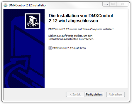

Start DMXControl
Figure 14:Installation completed
Figure 14: Installation completed
Once the installation has finished you have the opportunity to start DMXControl, or retun to Windows without starting the program.
