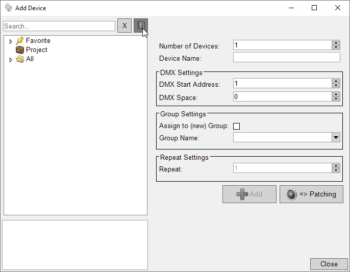

To download a device from the online library, open the Add Device dialog and click on the [Book] icon to the right of the search bar.
Figure 1:Add Device Dialog
Figure 1: Add Device Dialog

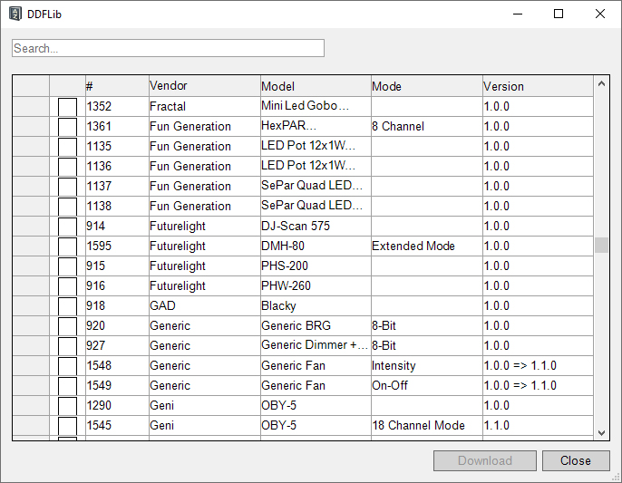

Now, the available DDFs will be retrieved from the DDF Library and listed. The window will only display the DDFs that are not yet available in your local library.
Figure 2:DDF Lib Dialog
Figure 2: DDF Lib Dialog
If there are DDFs with a newer version available in the DDF Library, the following will be shown in the "Version" column: 1.1.0 => 1.2.0. The first number represents the version already present on the PC, and the second represents the updated version in the DDF Library.
To download new DDFs or update existing ones, the corresponding devices must be selected using the checkbox at the front, and then click [Download]. The dialog will not close, allowing you to search for and download additional DDFs. To return to the Add Device dialog, click on the [Close] button.
